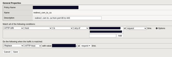

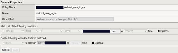

Hello,
I have a server that has a domain name and the corresponding SSL redirect. I was asked to add a second domain name to the same server and perform a redirect to the original name when the http request comes in before the SSL redirect.
I have created a policy, unfortunately the redirect gets executed before my policy and I end up with un-trusted certificate.
Any suggestion would be greatly appreciated.
Thank you,
dg.

    try this
    in the redirect to location, "[HTTP::uri]" to keep URI.

    Actually your suggestion was one of the first I did try. It is still doing the SSL iRule redirect first and then redirecting the URL. I am just wondering if a better solution would be to have a separate Virtual Server only for port80 and set the redirect Policy there. It is not that elegant but it should do it. On another side, I believe that Policies are evaluated before iRules, am I correct?
    Thank you,
    dg
