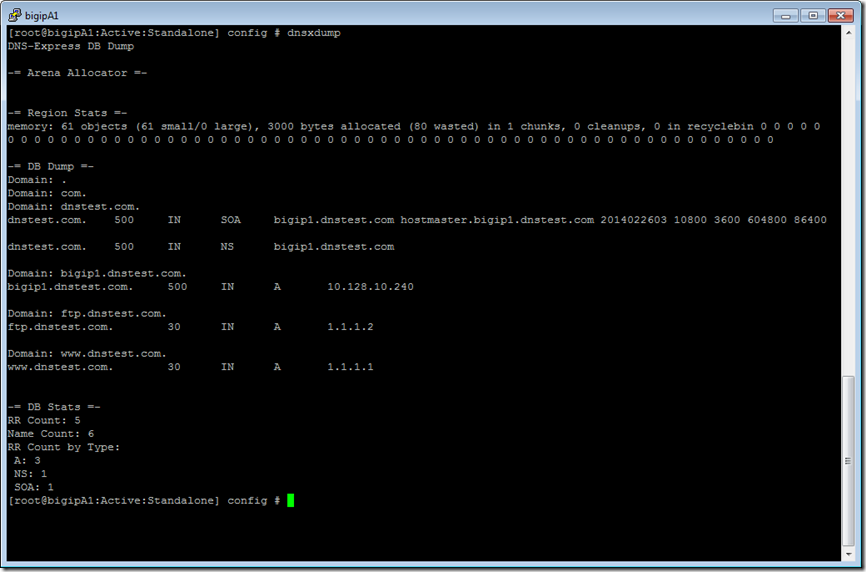

    Have you tried using dnsxdump in BASH mode
    The dnsxdumputility displays the DNS Express database information.
    The dnsxdump utility outputs directly to the console. If you have a large number of zones, or zone resource records, you can redirect the output to a text file for later review in your preferred text editor.
    For example, to redirect the output to /var/tmp/my_zones.txt you would type the following command:
    dnsxdump > /var/tmp/my_zones.txt

      use dnsxdump on bash to see the changes or you can take a pcap to capture those changes and see the negotiation between bigip and BIND because the incremental zone transfer depends on changes in SOA records between off-BOX BIND and bigip and what the time needed for these negotiations after the change of SOA record value to re-calculate the Delta for these changes on zones and create the IXFR to update BIGIP.
      So somehow I see this process still need sometime , the most important thing is how to configure your BIND correctly to follow the standard way for Zones transfer.
      Note:
      Be careful when using dnsxdump command , because if you have much zones and records your bigip may crash.
      I see using tcpdump to capture it and see the IXFR and it's relivant negotiations for zone transfers will give you the optimal visibility and how to calculate the time difference and delay.
