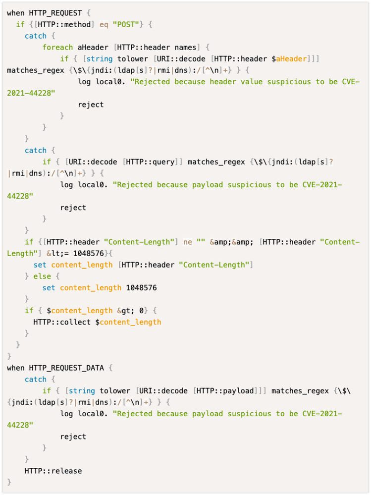

Hi @Daniel Martinez,
the following iRule will check the headers and the payload of any POST request for the stringand reject them.This iRule is provided "as is", without a warranty that it is a guaranteed protection against this CVE or any kind of performance testing.

- EDIT1: Since the vulnerability is applicable to any input field, I added also query parameters to be searched for the string .
- EDIT2: Updated to match regex for variants of LDAP, LDAPS, DNS, RMI
- EDIT3: added URI::decode to discover obfusction, as suggested by John Alam. Thanks for the hint!
Still not scanning the entire HTTP request with - EDIT 4: copy/pasted the code in as an image for syntax highlighting and to pass infrastructure rules that won't allow for "malicious" code. -lz

Last update from my side. F5 has provided iRules to mitigate CVE-2021-44228 here: https://support.f5.com/csp/article/K19026212
Due to a more strict regex the F5 iRule will also protect you against the recently observed more obfuscated variants such as:

You may want to consider scanning the entire HTTP request as one variable. [HTTP::request],
You may also want to normalize it using [URI::decode [HTTP::request]] , or [URI::decode [HTTP::payload]] , this way, attacks including "jndi%3Aldap" do not succeed.

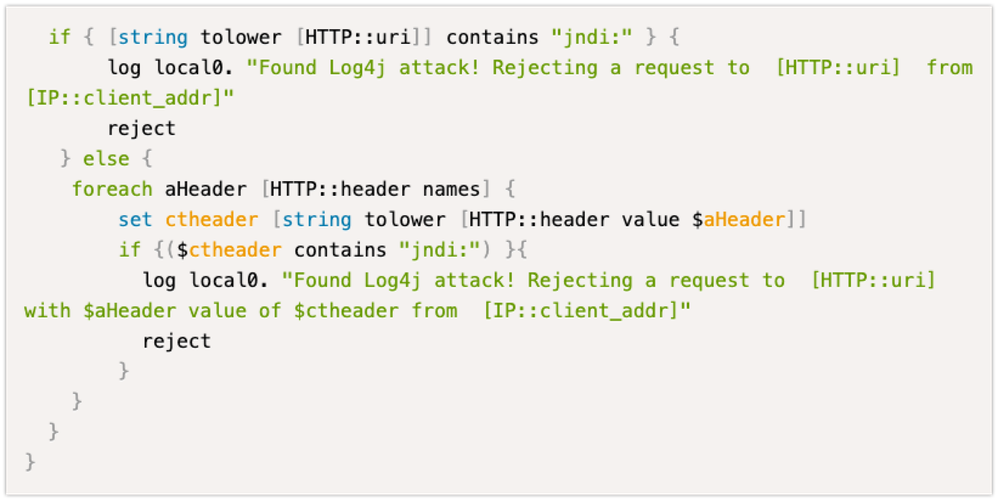

- SergeyAU
Altostratus
I just did quick and dirty
Not sure about the overhead on the iRule at the top
