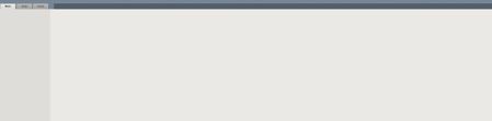

Mar 23, 2021Configuration Utility blank
HI! sometimes the configuration utility does not show the configuration information I tried to restart tomcat and httpd services, but i does not work. Finally, i have to restart the F5 appliance and...

Mar 27, 2021My guess you are running out of memory. See in the logs if you could find OOM error (OutOfMemory).
If thats the case, I would go & increase the memory provisioned for tomcat.
I have come across these situations in the past. The only solution was to provision extra mb for tomcat.
Keep us posted.

Mar 28, 2021Yup this will be seen in the kern log and F5 even has article how to investigate such issies:
https://support.f5.com/csp/article/K47241910
