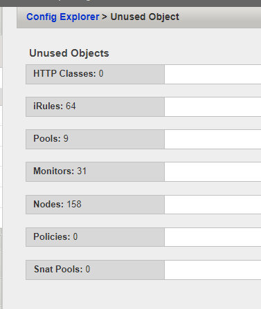

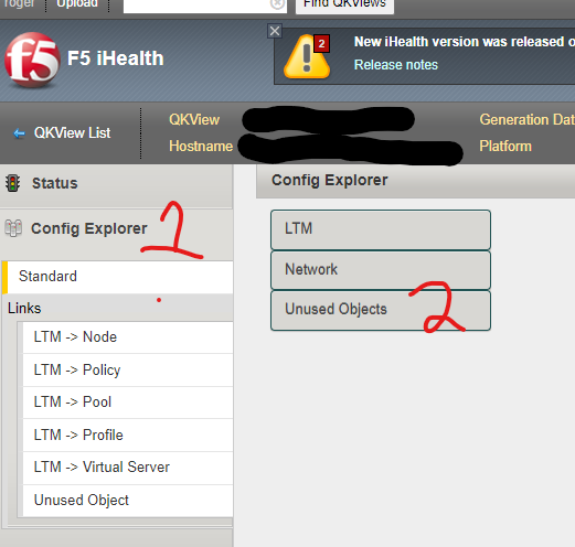

      I have identified the inactive objects by checking them on the Config Explorer > Unused Object of qkview uploaded to iHealth. Can we delete all those inactive pools and VS via script, one shot?

        using ihealth will not - should not display a VS that is not in use.... that being said, you are ok with deleting objects recommended as orphaned.   if there is a hook, the f5 - appiance will/should protect you ..... i.e. - a pool that is not referenced in a a virtual server config - yet -is referenced in an irule will be flagged - and not allowed to be deleted as nested.
        i would highly recommend using the ihealth as a spring board to a manual check via the gui or SCF file ( or other automation)  before deletion.
        as you can see in the screen shot below -  it does not reference the Virtual server...... if you delete a virtual server - its gone.....if you do delete all - they are gone....
        if you only delete the virtual server - and only the ones you are 100% positive are not in use - you are ok to ATTEMPT to delete the pool - and if its being called by other are areas ( irules or policies) - it will be flagged - and pre-vented from deletetion.   Before your attempt a bold move -you need to be positive that the pool in question does not have any other hooks or possiblities of backend configurations  AND - - AND - i would recommend 1000%
