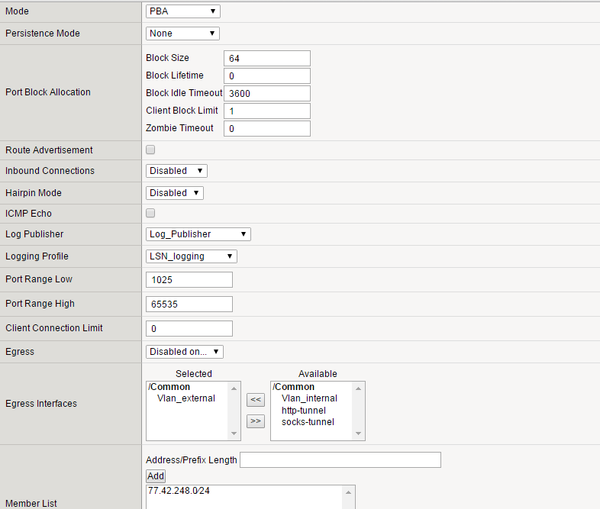

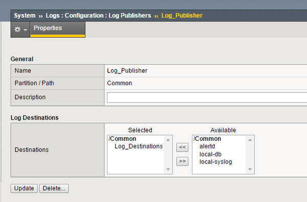

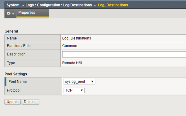

Hello, i've just tried it and unfortunately it did not work. Is there any troubleshooting tips that may help ? thank you
- VernonWells
Employee
Is it logging locally, or not at all? Can you share your LSN pool configuration, the Log Publisher, Log Destination and the Logging Profile configurations? Make sure you format it using block format so that it is easily readable.
- Mrad_231364
Dear Vernon, Please find the attached screenshots of the configuration. I just followed the simple steps. Thank you
- VernonWells
Employee
Actually, could you post the results of the following commands:
tmsh list ltm virtual tmsh list ltm lsn-pool tmsh list sys log-config publisher Log_Publisher tmsh list sys log-config destination Log_Destinations tmsh list ltm pool syslog_poolwhere is the name of the Virtual Server to which you've attached the LSN Pool, and is the name of the LSN Pool.
