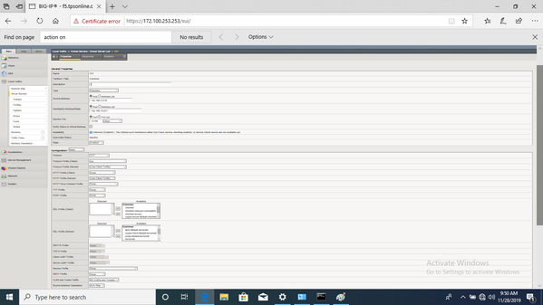

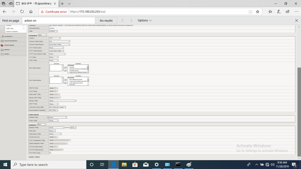

  • My question is simple. I have non-http transactions request from clients. The problem is that F5 load balancer make a persistent connection with one server while the other server is sitting idle.
    • Simon_Blakely's avatar
      Simon_Blakely
      It is not a simple question with the information we have available.
      Are all the transactions passed through a single connection on the client side ?
      What about the server side?
      What is the configuration of the virtual server?
      Simon_Blakely
      What about the pool and persistence profile?
      What sort of data is being passed across the virtual?
      The server-side will normally only close if the client side is closed - this is expected behaviour.
  • 1- What about the pool and persistence profile?
    is there any default persistence setting?
    2- What sort of data is being passed across the virtual?
    tcp transactions passes on virtual server
    3- The server-side will normally only close if the client side is closed - this is expected behaviour.
    So you say that client has to close the connection and there is no configuration on F5 LB ? means how then we can load balance/round robin the transactions which are getting a persistent connection.
