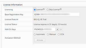

Went back to have a look at this again today and somehow for the first time looked closely at the Product Name column and then proceeded to call myself many variations of an idiot. 🙄
Not sure how long it has taken me to spot the blindingly obvious but it has been a while. Up till now I had been applying one of the BIG-IQ Centralised Management (CM) licences as highlighted in the red box. Tried one of the BIG-IQ Virtual Edition (VE) licences and it works exactly as it should with the option I wanted available.
