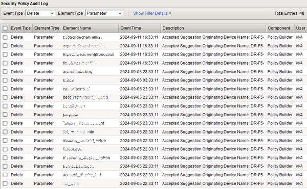

      • loipt_vpb's avatar
        loipt_vpb
        That's correct. You may want to see the Audit log. You will see the deletion of entities done by Policy Builder. That means F5 automatically deletes the entities depending on the setting of "Suggest to delete policy entity if it was not observed in traffic for more than 90 days"
