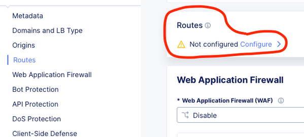

In Distributed Cloud, the solution would be to create an L7 route on the HTTP load balancer for each host. Here's an example for the a.b.com one, all three would follow the same steps.
1. Edit the configuration of your HTTP Load Balancer and click Configure.

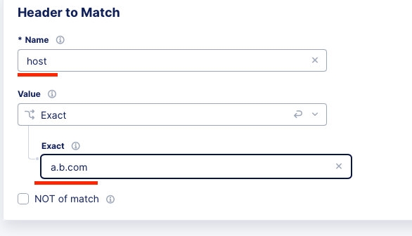

2. Set the route fields as shown and click Add Item within the Headers block.
3. Set the header name to Host with an exact value of a.b.com.

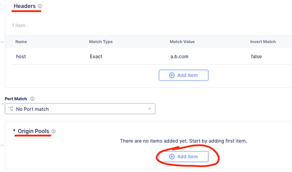

4. Finally click Add Item within the Origin Pools block and add your origin pool accordingly.
Once that route is added, you can repeat the same steps for c.b.com and x.y.com.
