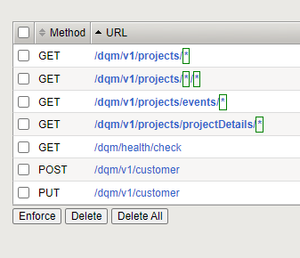

The resolution to this issue is to use the WildCards Order TAB to set the order the URLS should be processed.
By the way ChrisThuys / Chris_Thuys I seem to found a workaround as for example if you create the policy from the start like the one below it will result in the following order but you need to create asm policy from the start with the correct order as if you modify the openapi/swagger file it may not change the order.
