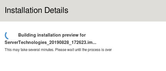

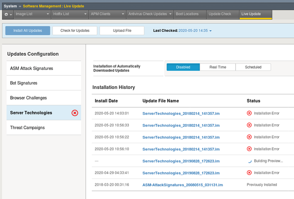

We have recently upgraded to version 14.1.2.3. When we first attempted to update the "Live Updates" they all failed because our Device ran out of space in /var. After clearing some space in /var we ran the updates again. We have managed to successfully update ASM Attack Signatures, Bot Signatures and Browser Challenges. However Server Technologies keeps failing. The Server Technologies section has a red cross in a circle and when we go into it, one of the entries for the latest update ServerTechnologies_20190828_172623.im has "Building Preview..." next to it and the icon just keeps spinning, screenshot attached. When we click on this entry the pop-up advises "Building installation preview for ServerTechnologies_20190828_172623.im... This may take several minutes. Please wait until the process is over", but the process never finishes (screenshot attached).
We have tried re-installing ServerTechnologies_20190828_172623.im, however nothing happens when we click on the "Install" button. We tried to install the previous update ServerTechnologies_20180214_141357.im and this failed with error message "Error installing installation ff80808171c349900172322e13dc005f: Live Update file could not be loaded". Please can anyone advise how to fix this?
