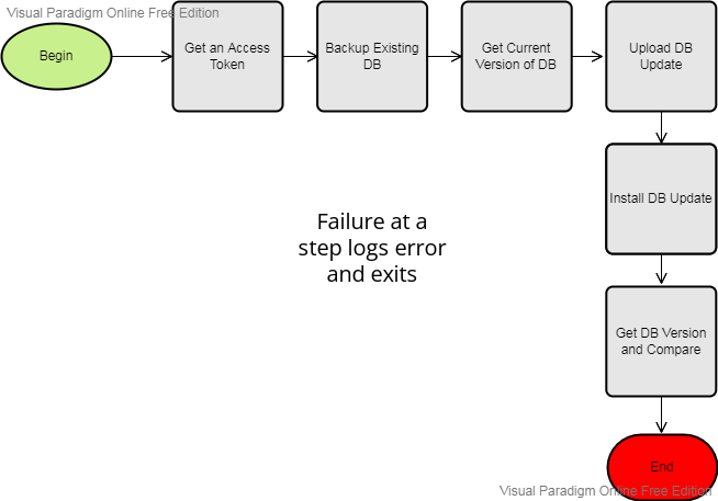

Design and dependencies
For this article, the design of the code will roughly follow the steps outlined in the F5 article located here F5 - K11176.  It is worth looking through this article and its suggestions if your intentions are to use this article and its code as a reference and build your own solution from scratch.  The rough design process is as follows:
This flow is extracted from the article reference as a rough outline of the steps we want to take.  Since we are using Python and we know that REST calls will be made in order to facilitate interaction with the BIG-IP device, we can also will in some of the dependencies we will need:
\n
\n
\n
\n
