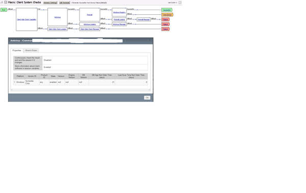

    Thank you for the response, yes I am using APM. Any ideas on the best way to export the VPE as it is very large.
    The issue is, we have a 3rd party trying to connect via SSL but failing with the error above. "Unsupported" I was thinking this is something to with the APM and client side checks we are doing.

  • pure guess, but 11.6. is getting old, might be just that.
    which browser does the 3rd party use? is the client checker running at all?
    do you have a VPE item called Logging anywhere in the flow?

    Did the client upgraded to win10 recently ? Or did he updated the local AV or FW ?
    I recommend you to update the EPSEC iso file so you can have the newest AV and FW list on your APM.
    After updating EPSEC retry...
    Check this KB: https://support.f5.com/csp/article/K48955220
