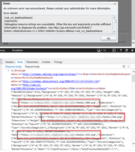

I've taken an iRule from another DevCentral post and modified it to fit my application. when HTTP_REQUEST { Disable the stream filter for all requests STREAM::disable LTM does not uncompress response content, so if the server has compression enabled and it cannot be disabled on the server, we can prevent the server from sending a compressed response by removing the compression offerings from the client HTTP::header remove "Accept-Encoding" } when HTTP_RESPONSE { Check if response type is text if {[HTTP::header value Content-Type] contains "text/xml"}{ Replace http:// with https:// STREAM::expression {@http:\\/\\/applicationdomain@https:\\/\\/applicationdomain@} Enable the stream filter for this response only STREAM::enable } } The stream profile is successfully replacing the HTTP: with HTTPS:, but is also including the additional backslash and a Silverlight (smh) error pops up When I remove the second backslash in the iRule, the HTTP: is no longer replaced with HTTPS:, and I'm back to square one. Any ideas on what I might be doing wrong? Thanks in advance!362Views0likes1CommentXML Threat Prevention
