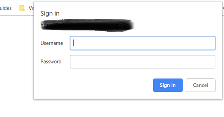

Hello, we are using APM for SAML authentication. Domain joined machines should authenticate transparently with Kerberos, users without the ability to use Kerberos (non domain joined, Firefox without negotiate-settings) should receive a form to login. Kerberos works fine, but users with non domain joined machines receive a browser authentication prompt and "Authentication required to access the resources.". Does anybody has set up such a scenario? Any help is appreciated.4.3KViews0likes39CommentsUsing F5 as a Service Provider with Okta IdP
