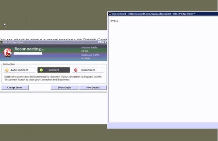

Recently when connecting using BIG-IP Edge Client, users are now getting a popup window that seems to be coming from "https://www.f5.com/apps/all/avail.txt"; and the window is blank and has the text "avail" in it. If the window is closed the connection is terminated, if the window is left minimized the client stays connected. Running APM version 11.5.3, no recent changes have been done. Attached image of the popup window. Any suggestions what could be causing this all of a sudden?Solved1.6KViews0likes4CommentsIs Window 7 supported?

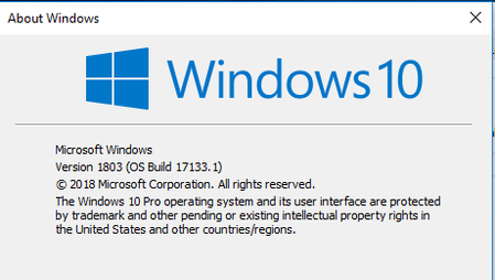

Hi everybody Windows 10 Release 1803 will be delivered in the next few days to the public. We are running the latest build from the Windows Insider Program: Unfortunately the Big-IP Edge client version 7160,2018,118,2335 (APM 13.1.0.5) is not working with this Windows build. The VPN connection cannot be established. First error message in logterminal.txt [User]: Error CURDialer::InitializeConnectionThreadProc, Failed to set entry properties in C:\Users\AppData\Roaming\Microsoft\Network\Connections\Pbk\rasphone.pbk (error: 0x278) Does anybody get the Big-IP Edge client worked with Windows 10 1803? Thank you, John974Views0likes7CommentsF5 Access for Mac OS client
