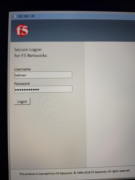

Hi, I'm having an annoying issue where the password field on the OTP Logon page is already filled in (with *****) each time I log in to the APM. (Seems to only be this way in the Edge Client). I would like to have the field cleared and not remembered since it's an OTP after all. I've searched in the VPE / Customization where to configure this without any luck, and my html/javascript coding skills are too lacking. Any tips? Kind Regards, Marcus784Views0likes5CommentsBig-IP Edge Client can I clear the user entered servers?
