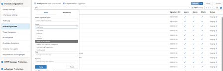

Hi All, Problem scenario is this: Multiple F5 ASM deplyoments which use BigIQ to push out updated attack signatures ( works well ) and a 14 day Enforcement Readiness Period. This all works well up to this point, where someone manually has to go and click the "Enforce Ready Entities" button. That sounds like a minor thing to do, but in an Enterprise it includes change control/PVT etc to do... ...but automating this out as a fortnightly thing should reduce risk and I can do other things. So I am comfortable with the API, but looking at v13/v14 API I dont see a functionality that can do this for me. Has anyone done this last step to fully utomate attack signature updates ?Solved4.3KViews1like15Comments
