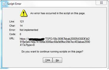

Hi DevCentral community! I have a problem with the ASM and Javascript challenge, let me explain you what is happening, what is configured and what I searched :) 1) - I have configured an ASM Policy, on V12.1.2, where DoS protection is disabled, CSRF Protection is disabled and Web Scraping is disabled (this is not decided by me, it's a money thing between boss-client). 2) - Since the ASM was enabled in blocking mode, after 21 days of learning period, a pop-up appears when users try to edit Documents from SharePoint: The URL is https://XXX/TSPD/..... 3) - I read the Proactive Bot defense Guide and the Web Scraping Bot Detetion article also, I 've searched on DevCentral for similar problems Even I read this I'm not sure 100% sure why is happening this issue. Seems, per this question that even if everything is off, challenge can be set. I'm not sure how to solve it, this is what I understood that I have to do: Whiteliste on a LTM policy the resource path (disable the ASM) Whitelist on a LTM policy /TSPD/ and /TSbd/ path (disable the ASM) Check that javascript is enabled on the Browser Disable the caching of dynamic pages by injecting 'Cache-Control: no-cache' Thanks for your time and your help! Regards5.3KViews0likes2CommentsRemove the "Server" header
