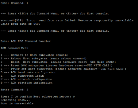

Hi there, I am setting up my first pair of virtual edition (VE) BigIPs currently and struggle to get AOM network access running. When using physical BigIPs ESC-( does the trick, but when trying to enter this via the ESX console, as soon as I type ESC I get ^[ so I won't be able to access the AOM menu. Looking at K14594: Accessing the AOM Command Menu I am not seing VEs listed anywhere. So am I right that VEs generally do not offer any AOM at all and the idea is to do all the maintenance/troubleshooting via the ESX console? If not - how do you configure network access to the AOM for VEs? Cheers, Torsten408Views0likes2CommentsError starting 8900
Hi, i have 3 8900 with the same trouble. All don't start the TMOS. I try use the AOM but when i try any option says that the host is unreachable. Anyone have any idea what can i do? I try a clean install with USB but the USB don't start until the stop screen Or all them dont have more solution? Thanks319Views0likes2CommentsRunning EUD from CLI or AOM
