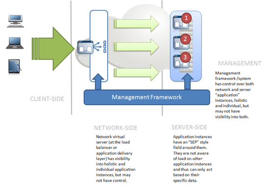

But let’s assume it could, or that the developers integrated the application appropriately with the management framework such that the application could initiate a scaling event. This works for the first instance, but subsequently becomes problematic – and expensive. This is because visibility is limited to the application instance, not the application as a whole – the one which is presented to the end-user through network server virtualization enabled by load balancing and application delivery. As application instance #1 nears capacity, it initiates a scaling event which launches application instance #2. Any number of things go wrong at this point:
- Application instance #1 continues to experience increasing load while application instance #2 launches, causing it to (unnecessarily) initiate another scaling event, resulting in application instance #3. Obviously timing and a proactive scaling strategy is required to avoid such a (potentially costly) scenario. But proactive scaling strategies require historical trend analysis, which means maintaining X minutes of data and determining growth rates as a means to predict when the application will exceed configured thresholds and initiate a scaling event prior to that time, taking into consideration the amount of time required to launch instance #2.
- Once two application instances are available, consider that load continues to increase until both are nearing capacity. Both applications, being unaware of each other, will subsequently initiate a scaling event, resulting in the launch of application instance #3 and application instance #4. It is likely the case that one additional instance would suffice, but because the application instances are not collaborating with each other and have no control over each other, it is likely that growth of application instances will occur exponentially assuming a round robin load balancing algorithm and a constant increase in load.
- Because there is no collaboration between application instances, it is nearly impossible to scale back down – a necessary component to maintaining the benefits of a dynamic data center architecture. The decision to scale down, i.e. decommission an instance would need to be made by…the instance. It is not impossible to imagine a scenario in which multiple instances simultaneously “shut down”, neither is it impossible to imagine a scenario in which multiple instances remain active despite overall application load requiring merely one to sustain acceptable availability and performance.
These are generally undesirable results; no one architects a dynamic data center with the intention of making scalability less efficient or rendering it unable to effectively meet business and operational requirements with respect to performance and availability. Both are compromised by an application-driven scalability strategy because application instances lack the visibility necessary to maintaining capacity at levels appropriate to meet demand, and have no visibility into end-user performance, only internal application and back-end integration performance. Both impact overall end-user performance, but are incomplete measures of the response time experienced by application consumers.
To sum up, the “application” has limited data and today, no control over provisioning processes. And even assuming full control over provisioning, the availability of only partial data leaves the process fraught with potential risk to operational stability.
