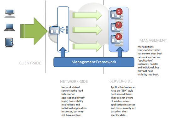

We’ve examined each of the three possibilities, the three “players” in the scalability game in dynamic environments: the network, the application, and the management framework. All have a piece of the puzzle, but none have both the visibility and the ability to initiate a provisioning event – at least not in a way that maintains cost and operational efficiency.

From our previous discussions it seems obvious that the application does not – and indeed cannot – be enabled with the control required to manage scalability. But the network (load balancing service) and the management framework both could, ostensibly, be enabled with the ability to control the provisioning process and imbued with the visibility into the data necessary to initiate scaling events. But just as true is that doing so, in either case, would incur serious repercussions to operational stability and potentially increase costs when the integration requirements are taken into consideration.
Thus, it seems the most efficient and cost-effective means of managing scalability in cloud computing environments is via a collaborative operational process involving all three components: application, network, and management framework.

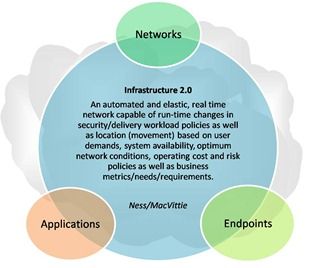

You may recall that the definition of “Infrastructure 2.0” was so broad as to seem unrealizable. But when combined with the unspoken requirement for collaboration across components, such a definition is certainly not only realizable, but desirable. Infrastructure 2.0 was never about a single component being able to provide everything, it was always about enabling collaboration of the infrastructure in a manner that has been successfully carried out in the software arena to provide a highly-connected, intelligent “network” of applications.
By leveraging collaboration in the infrastructure we can achieve the goal of a dynamic data center. Whether the result is simply highly virtualized or a fully cloud-computing enabled architecture is not nearly as relevant as making the data center more operationally efficient through integration and collaboration.
