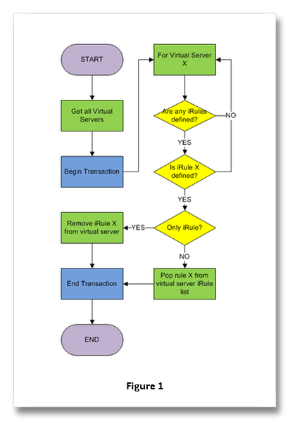

A Little Planning Goes a Long Way
Sometimes I get ahead of myself and start scripting immediately. This is more fun, but always results in rewriting something as I’ve certainly made logic errors and assumptions that don’t pan out. So let’s start with the high level approach, and then work our way into code.
Consider this virtual server configuration:
Virtual Server Configuration
ltm virtual tmshtest10 { destination 10.10.20.159:http ip-protocol tcp mask 255.255.255.255 pool att_rtr profiles { http { } stream { } tcp { } } rules { filler1 filler3 filler4 filler5 } }
Each of these keywords and values can be accessed in tmsh as an object. I don’t really care about any of the keywords in a virtual except rules, since it’s only a specific iRule I want to remove. So that’s the first test in the script. After collecting all the vips into a variable, I want to loop through that list and test for the presence of that keyword. If it is not defined, I can move on to the next virtual. Once I’ve verified the keyword is present, however, I next need to see if the iRule I want to remove is defined within the rules keyword. If it is, then I want to take action on this virtual server. Since there is no remove action associated with iRules, I need to test how many iRules are currently applied. If the iRule I want to remove is the only one, I can just modify the virtual server with the rules none attributes. However, if there are more than one, I need to “pop” the specific rule from the list, then re-apply the iRules that will remain. Finally, I’ll wrap all the looping and modification into a transaction, so if there are any failures in the script the desired actions will not be committed. If you are a visual learner, the approach I’ve just described is presented in a workflow diagram in Figure 1.
