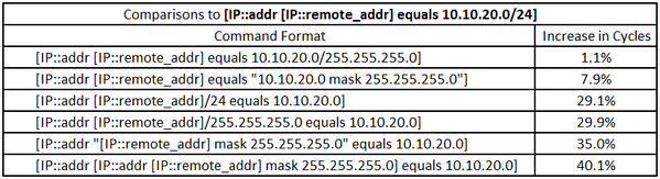

Before running each format through a simple test (ab –n 10000 –c 25 http://<vip>), I set up a control so I could isolate the cycles for each format:
when HTTP_REQUEST timing on {
### CONTROL ###
if { 1 } { }
Since all the formats will return true if the match is found, then subtracting out the average cycles from this iRule should give me a pretty accurate accounting of cycles required for each specific format. So I can replace the “1” from the conditional with each format, as shown in this iRule:
### FUNCTIONAL EQUIVALENTS "RECOMMENDED" ###
# Format #1 Cycles: 6839 - 1136 = 5703
# if { [IP::addr [IP::remote_addr] equals 10.10.20.0/24] } { }
# Format #2 Cycles: 6903 - 1136 = 5767
# if { [IP::addr [IP::remote_addr] equals 10.10.20.0/255.255.255.0] } { }
# Format #3 Cycles: 7290 - 1136 = 6154
# if { [IP::addr [IP::remote_addr] equals "10.10.20.0 mask 255.255.255.0"] } { }
### FUNCTIONAL EQUIVALENTS "NOT RECOMMENDED" ###
# Format #4 Cycles: 8500 - 1136 = 7364
# if { [IP::addr [IP::remote_addr]/24 equals 10.10.20.0] } { }
# Format #5 Cycles: 8543 - 1136 = 7407
# if { [IP::addr [IP::remote_addr]/255.255.255.0 equals 10.10.20.0] } { }
# Format #6 Cycles: 8827 - 1136 = 7691
# if { [IP::addr "[IP::remote_addr] mask 255.255.255.0" equals 10.10.20.0] } { }
### ALTERNATE FORMAT ###
# Format #7 Cycles: 9124 - 1136 = 7988
# if { [IP::addr [IP::addr [IP::remote_addr] mask 255.255.255.0] equals 10.10.20.0] } { }
### CONTROL ###
# Cycles: 1136
# if { 1 } { }
You can see from the average cycles data I added to each of the formats comments above that the recommended formats are all faster than the formats that are not recommended. What’s interesting is the subtle differences in the “/” formats within each group of functional equivalents and then the significant outliers that the “<net> mask <mask>” formats are within their group. Also of note is that the last format, while acceptable, is really inefficient and should probably be avoided. The table below breaks down the increase in cycles for each of the formats compared to the best performer: [IP::addr [IP::remote_addr] equals 10.10.20.0/24].
Whereas the number of cycles required to execute this operation are all quite small, the difference beyond the first two similar formats is quite significant.
Conclusion
Many ways to skin a cat, some good, some not so good. Just to be clear, using the mask on the initial argument of the comparison should be avoided, and if you currently have iRules utilizing this format, it would be best to update them sooner rather than later. I’ll be doing the same on all the DevCentral wikis, forums, articles, and blogs. If you find some references where we haven’t made this distinction, please comment below.
