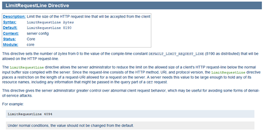

Assuming for whatever reason that this isn’t possible (and we know from research and surveys and live data from organizations like WhiteHat Security that it isn’t for a number of very valid reasons) it is likely the case that information security and operational administrators will go looking for a secondary defense. As the majority of applications today are deployed as web applications, that generally means looking to the web or application server for limitations on URL and/or parameter lengths as those are the most likely avenues of attack. One defense can be easily found if you’re deploying on Apache in the “LimitRequestLine” compilation directive.
Yes, I said compilation directive. You’ll have to recompile Apache but that’s what open source is all about, right? Customization. Rapid solutions to security vulnerabilities. Agile infrastructure.
While you’re in there, you might want to consider evaluating the “LimitRequestFields” and “LimitRequestFieldSize” variables, too. These two variables control the number of HTTP headers allowed as well as the length of a header field and could potentially prevent an exploit of the platform and underlying operating system coming in through the HTTP headers. Yes, such exploits do exist, and as always, better safe than sorry.
