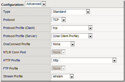

First you’ll need to ensure that you have the Stream Profile enabled for your virtual. You can enable this by navigating to: Virtual Servers –> <YourVirtual> –> Configuration: Advanced. Here you’ll see lots of options, one of which is where you’re able to select any of the stream profiles you’ve created, or the default stream profile, which will work fine for our purposes.

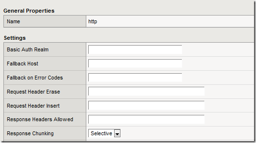

Next you’ll want to make sure that you’re accounting for the possibility that the responses that you’re looking to modify coming from the server are chunked. If they are, we have to expect it otherwise you won’t be able to accurately modify the payload. There’s an easy fix for this though, in the Response Chunking option within the HTTP profile. If you’re using the default profile, this should be set to Selective by default anyway, which will work just fine with the Stream profile.
