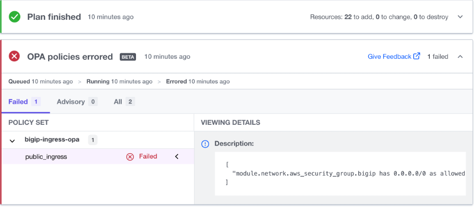

The screenshot below shows how OPA flagged a failure when the SSH security group for BIG-IP is accidentally left wide open. The OPA Policy will show the failure when the Terraform plan is run and will not allow the BIG-IP instance to be deployed in the cloud.

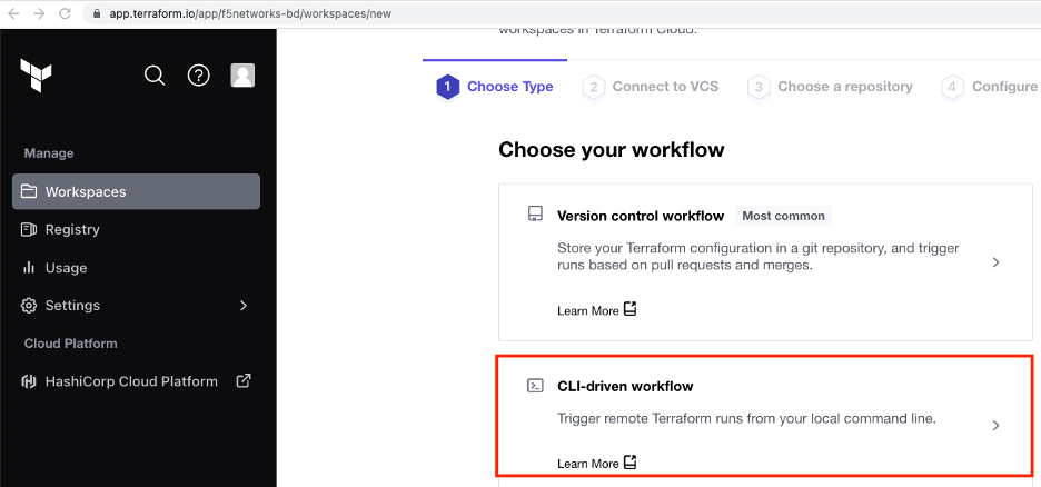

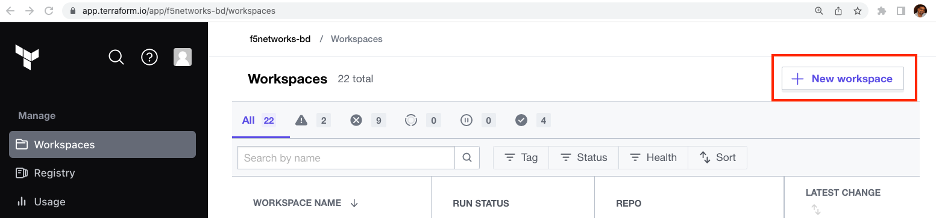

  • Select the  CLI-driven workflow option. We are selecting the CLI-driven option so that we can issue Terraform CLI commands from the terminal that you are using on your laptop. The Terraform state information will be securely stored in Terraform Cloud.
  • Provide a workspace name matching what you have in the terraform.tf file  as shown.

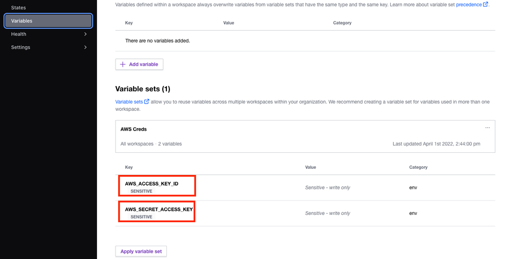

  • Staying on the workspace option select variables on the left as shown below, Add AWS Credentials to the workspace.  Make sure the values are marked sensitive as shown.

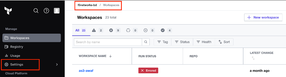

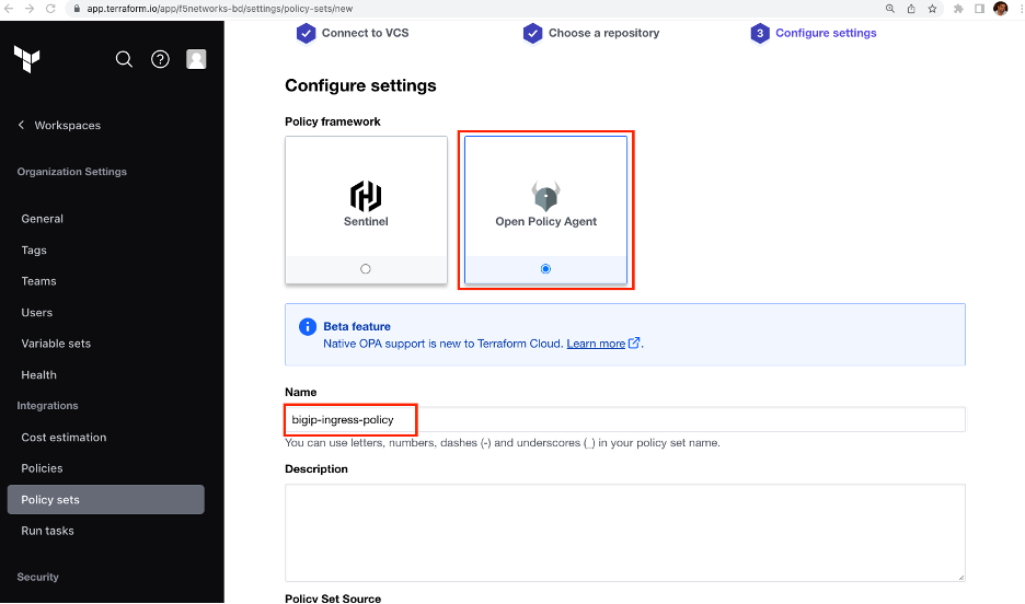

  • Next create an OPA policy set in Terraform Cloud, to create the OPA policy. Click on your organization name and then settings on the left as shown below:

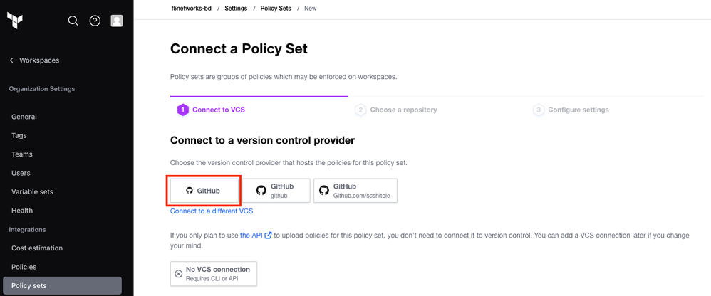

  •  Then click on Policy Sets just below the policies to create a new OPA Policy

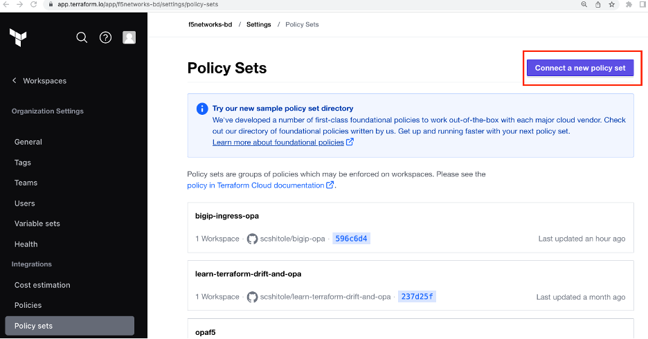

  • Click on Connect a new policy set as shown below
  • Click on GitHub and connect your VCS repository which you did a git clone in Step 1

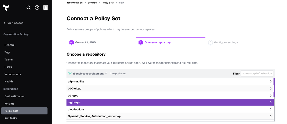

  • You can browse to locate the repository; in your case, it will be your forked repository
  • Then select the option Open Policy Agent and provide any name to the policy.
  • Click the option “Policies enforced on selected workspaces” and the new workspace you just created to the policy as shown below. Finally, click on connect policy set. This will apply the policy to the workspace.

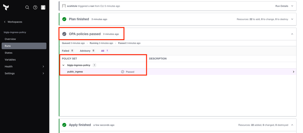

  • Go to terminal CLI and issue command terraform init & terraform apply
  • The policy will be triggered, and you can see it on the terraform cloud
  • The OPA policy will fail and show the reason in the description
  • You will see the OPA policy in action and it will not allow the BIG-IP to be deployed in the cloud before we fix the issue, in this case, the security group needs to be something other than “0.0.0.0/0”

Once those changes are made, we need to commit those changes into GitHub as the new changes will be picked by the OPA policy and Terraform Cloud.
  • Do git commit with those changes in main.tf   file, are reflected on the GitHub repository.
  • Execute terraform apply and you can see that the OPA policy is passed and the deployment of BIG-IP moves forward.

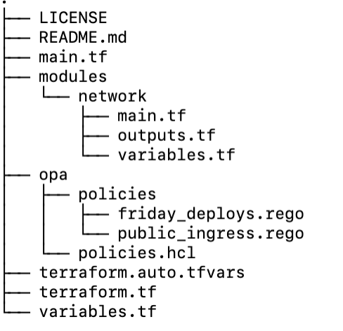

OPA file structure on GitHub
You can see that all the policy files are under the OPA directory
The policies are defined in policies.hcl file, in the above example we saw the policy “public_ingress” was used

To further see details about the public_ingress policy, we need to check the file under opa/policies/public_ingress.rego
