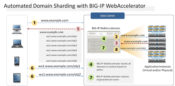

DOMAIN SHARDING with BIG-IP WebAccelerator
What BIG-IP WebAccelerator does, automatically, is shard domains by adding a prefix to the FQDN (Fully Qualified Domain Name). The user would initiate a request for “www.example.com” and WebAccelerator would go about its business of requesting it (or pulling objects from the cache, as per its configuration). Before returning the content to the user, however, WebAccelerator then shards the domain, adding prefixes to objects. The browser then does its normal processing and opens the appropriate number of connections to each of the hosts, requesting each of the individual objects. As WebAccelerator receives those requests, it knows to deshard (unshard?) the hosts and make the proper requests to the web or application server, thus insuring that the application understands the requests. This means no changes to the actual application. The only changes necessary are to DNS to ensure the additional hosts are recognized appropriately and to WebAccelerator, to configure domain sharding on-demand.
This technique is useful for improving performance of web applications and is further enhanced with BIG-IP platform technology like OneConnect which multiplexes (and thus reuses) TCP connections to origin servers. This reduces the round trip time between WebAccelerator and the origin servers by keeping connections open, thus eliminating the overhead of TCP connection management. It improves page load time by allowing the browser to request more objects simultaneously.
