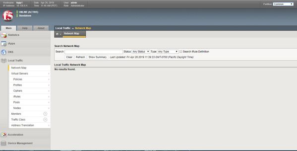

Now we are ready to run the container  maybe a good time for a 'nothing up my sleeve' moment - here is the state of the BIG-IP before hand
Now let's run the container from our image.  The -tty flag attached a pseudo terminal for output and --rm deletes the container afterwards:

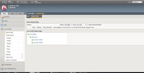

Success, by the looks of things. Let's check the BIG-IP:
running our container has pulled down the AS3 declaration, and applied it to the BIG-IP. This same container can now be run repeatedly - and only the AS3 declaration stored in git (or anywhere else your container can get it from) needs to change.
