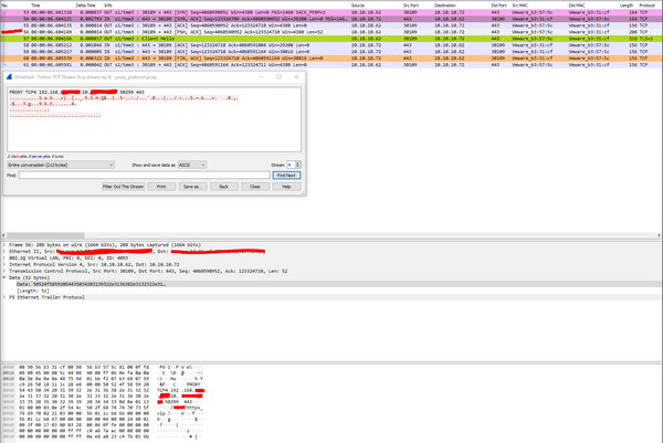

If you're curious what this looks like in a packet capture where you do SSL re-encrypt on the virtual server, terminate SSL at the F5 then re-encrypt HTTPS to the pool members, the data is within a server side packet after the three way handshake with PSH and ACK flags set.
The data is hex encoded but if you right click the PSH,ACK packet and follow stream wireshark will decode it or you can use another resource.
Here's what the proxyheader looks like: PROXY TCP4 192.168.x.x 10.x.x.x 50299 443
