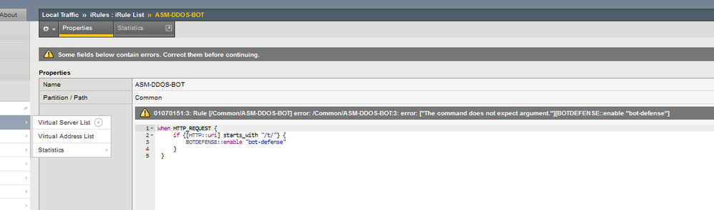

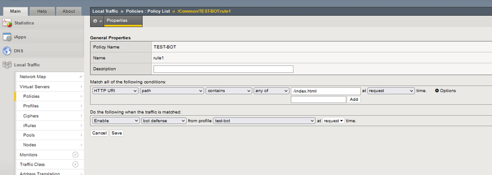

Why does the Local Traffic policy allow Bot profile to be selected but the iRule can't ?
When I attach DOS and BOT profiles with local traffic policy or iRule I always need a default BOT and DOS profile even when I have a default rule that catches all the traffic. That is one thing but the strangest thing is when I decide to attach a Bot profile with iRule it does not work but the Local traffic policies allow this.
I will need to test this but is really strange. This is the first time something is only possible with Local Traffic Policies but I will have to test if it works 🙂

    • You need to have a profile applied to a VIP to engage that HUD filter. From there you can programmatically enable/disable the profile.
    • The error in the iRule indicates that BOTDEFENSE::enable doesn't take an extra parameter. It just enables the attached BD profile. An LTM policy can uniquely select and apply a BD profile.
