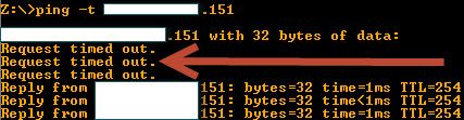

Hi, Many times I cannot access a webapp using the Virtual Server.
When pinging the VS IP address and the get "Request timed out." for a while
And after a while, the VS starts responding to PING and then, I can access the webapp.
Why does it happen? why the VS stops responding and after a while it comes back alive?
Is the VS going to sleep if it's not in used for a while?
See the screenshot:

when I ping from my station it does not answer to ping immediately, as seen in the above ping screenshot, but when pinging the VS from BIGIP cli, it answers immediately.

It seems to be a problem in one the router's ARP table size
When pinging from that routing device, I get:Code connect: No buffer space availableWhen I increase the ARP table size, I am able to ping from that routing device
and normally from my PC.
Thank you for directing me to the solution.
