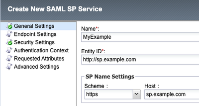

So in this case the Audience URI and the Single sign on URL would be based on the DNS hostname for the VIP your access policy is attached to, meaning: the way that Okta would communicate with the SP and what appears in your browser.
In the BIG-IP interface, the Audience URI is the same as the Entity ID field from the SAML SP Service editor, in the General Settings section.
The Single Sign-on URL is a combination of the Audience URI, followed by the URL path /saml/sp/profile/post/acs. This is also called the Assertion Consumer Service URL. The path should always be the same, but the hostname would change for each unique service provider/application. Example: https://sp.example.com/saml/sp/profile/post/acs.
In the linked guide you can see in the example that their Audience (SP Entity ID) is https://app.f5sec.net, and the Single Sign-on URL is https://app.f5sec.net/saml/sp/profile/post/acs.
