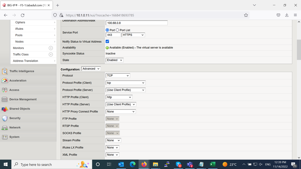

Hello Dears i have mluti servers working with different ports like 8080 , 8090 ... etc and all of them are load balnacing using F5 i am asking if it's double to make user reach the servers using sta...

    > Virtual server "100.68.0.8" listens on 443 , it performs destination NAT to both Pool_members "100.66.0.8" and "100.66.0.7".

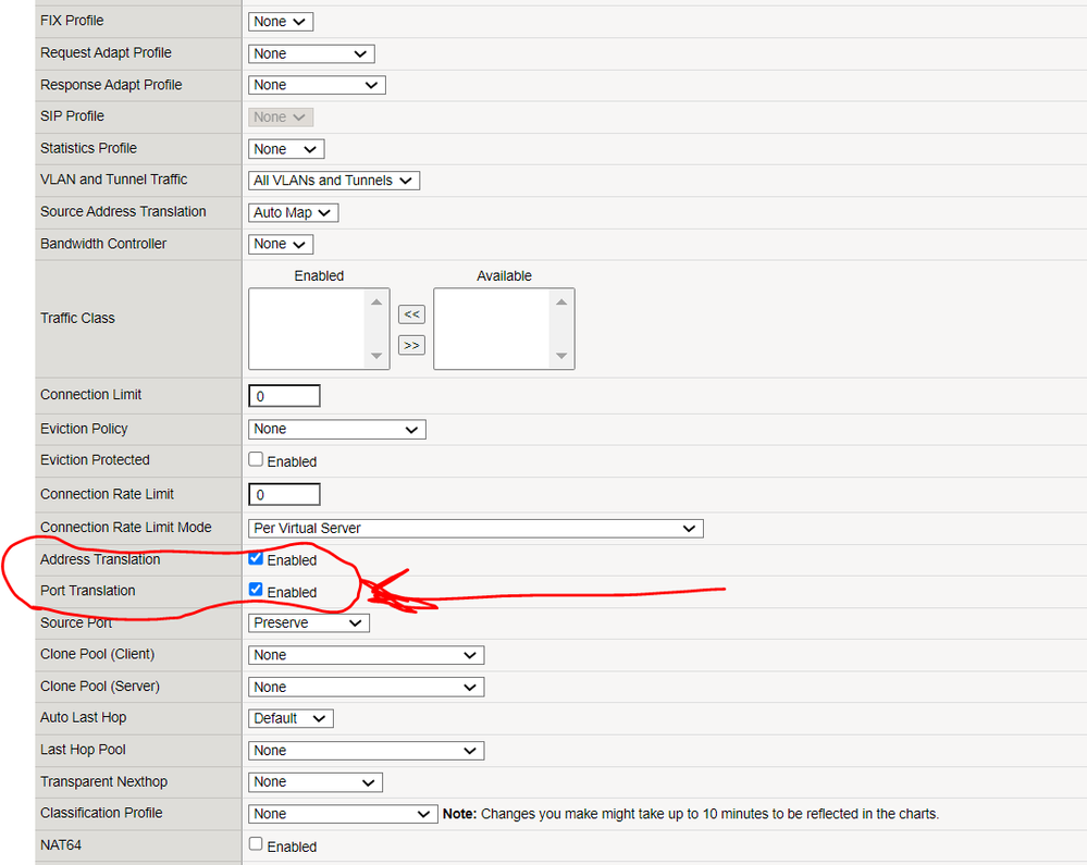

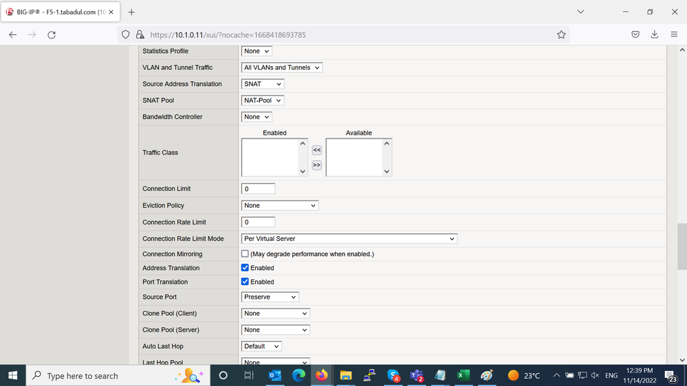

    But What about the port translation ,
    443 port can not be translated to port "0" , Port "0" means any.
    so in this case , F5 does not perform a Port address translation it transfer the traffic on Port 443 as it is without translation to port 7134.
    > so the needed action is to change "0" to 7134 on both of pool members.
    Thats why you access it when configuring the virtual server to listen on port 7134 not 443 as you did recently.
