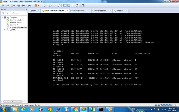

      Thanks for your quick reply. Yes i am getting ARP entry of my internal VLAN nodes in ARP table.
