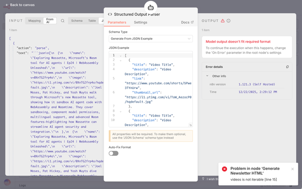

The failure always showed up in the Structured Output Parser. n8n would run the flow, then the parser would throw: "Model output doesn't fit required format,"
Which is a super reasonable error if your model is rambling, adding commentary, wrapping JSON in markdown, returning tool traces, whatever. So that’s where my head went first: “Okay, I need to tighten the prompt. Maybe the schema is too strict. Maybe Ollama’s being weird.”
But here’s the thing: this wasn’t one of those “LLM didn’t obey” moments. This was repeatable, consistent, and it didn’t really matter how I tuned the prompt. The OpenAI version worked; the Ollama version failed, and the parser was just the first place it showed up.

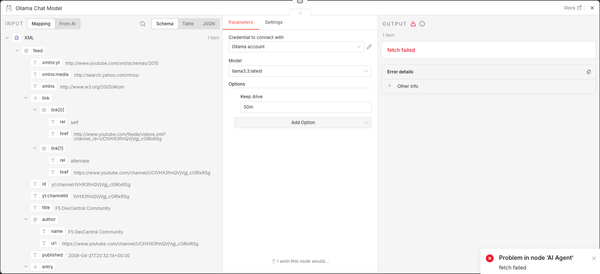

As I dug in, I started seeing a pattern: a hard failure at exactly five minutes. Not “about five minutes,” not “sometimes,” but right on the dot. That error often surfaced as: "fetch failed."
So now we’re not talking about a formatting issue anymore—we’re talking about the request itself failing. That matters, because if the model call dies mid-stream, the structured parser downstream is going to be handed something incomplete or empty or error-shaped, and it’s going to complain that it doesn’t match the schema. That’s not the parser being wrong. That’s the parser doing its job.

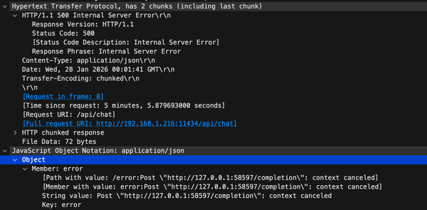

At some point I wanted proof of what was actually happening on the wire, so I ran a tcpdump against the Ollama port. And yeah—this is where it got real.
What I saw was:
  1. n8n connects to Ollama fine
  2. Data flows for a while (so we’re not talking about “can’t reach host”)
  3. At the ~5 minute mark, n8n sends a TCP FIN/ACK (client closes connection)
  4. Then also sends an HTTP 500 containing an error like "context cancelled"
In the issue thread, you can literally see an example of that pattern: client FIN from n8n → Ollama, then 'HTTP/1.1 500 Internal Server Error' with a body indicating: 'context canceled.'
So when I originally said “the structured output parser fails because Ollama’s tool call output isn’t close to what’s expected,” I wasn’t totally wrong about the symptom. But the deeper “why” is: the request is being canceled and what comes back is not a valid structured model output. The parser is just where it becomes obvious when you force the node to return data back to the agent.

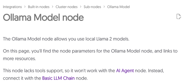

The n8n Ollama model node does not work with LLM Tools implementations.
That’s not a rumor. That’s in the n8n docs!
After a quick recap and discussion, JRahm​  pointed me to the documentation for the Ollama model integration, and it straight-up says the Ollama node does not support tools, and recommends using Basic LLM Chain instead:
