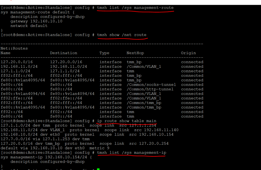

Thanks for the article. we went through it and tried the below commands to check the connection.

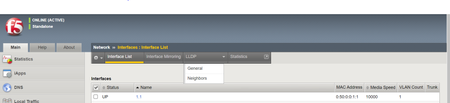

We checked the configuration and noticed that IP address assigned to Interface 1.1 is showing Connected in Origin
Interface 1.1> Self-IP > 192.168.11.140

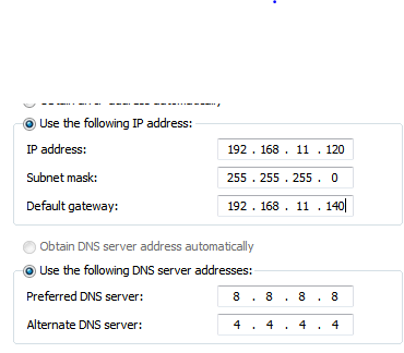

Virtual PC directly connected to Interface > Self-IP> 192.168.11.120
Default Gateway for Virtual PC is set Interface 1.1 IP (Please find the image below)
Also As of now, We only have F5 and Virtual PC in our Environment. we have not configured any other firewall and router.
We have added one route as test in Network>Routes.
Could you please let us know which settings to change to get Internet connectivity in Virtual PC (192.168.11.120)
