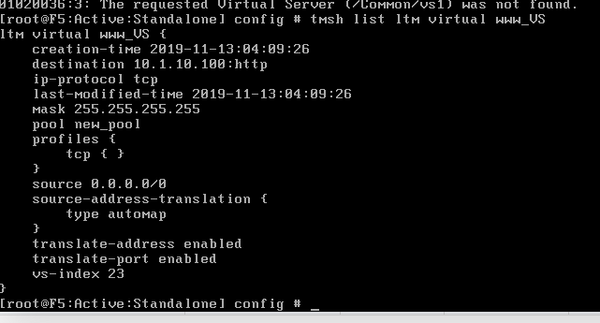

      Can you show us the configuration of the virtual server?
      tmsh list ltm virtual {virtual-server name}

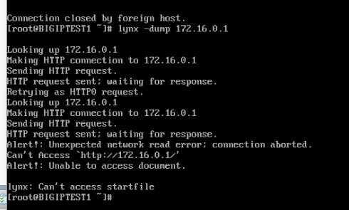

  • Yes I have tried . See below result. I did ping will response but tcpdump showing nothing also lynx VS IP but failed

      If I understand from the images you shared, you are accessing from a Big IP to a resource behind another Big IP.
      Please perform a traceroute from BIGIPTEST1 to the VIP on F5 .. Traffic is not reaching F5 which could mean that there is another device on the network is intercepting the traffic.
