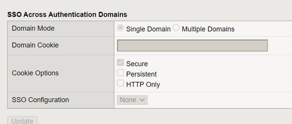

  • You can create 2 APM policies and use SSO domain cookie. This will avoid authentication if user from app1 goes to app2 in same session or diffrent tab of same browser.
    under domain cookie, type your site domain. e.g. example.com

    that's ok for the authentication between the two VS, I managed to do it using one single APM policy and you're true the SSO domain cookie avoid user to be prompted
