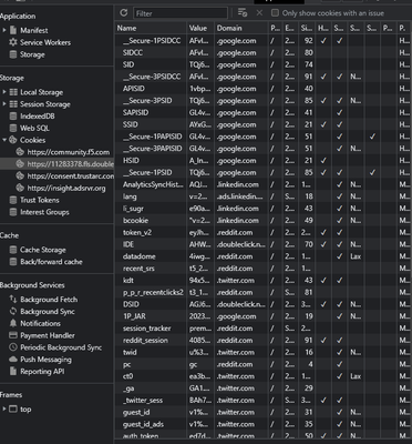

Trying to find a way to delete cookie with a domain name using irule
Hello,
I'm trying to delete cookie that have a domain name set. For example in the below pciture, there are cookies with domain name reddit, let's say I'd like to delete it with an irule
I checked the documentation and wrote the below irule to test but it doesn't seem to work. Any ideas why it doesn't work ?
