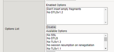

Then under your ssl profile you need to chnage the config from "Basic" to "Advanced"
Then you'll see the Options List
Here is mine, it appears its flow down so NO DTLSv1.2 turns off everything below that and leaves TLSv1.3.

If that is the case then I'm not sure where the TLS is showing up as being open, in our profile we have NO_TLSv1.3 so that should cover 1 and 1.1.
Does it use the Options if it's greyed out or do I need to actually select the checkbox for the profile to "use" it?

Now, i used the cyphers profile which also controled tls1.0, 1.1 1.2 etc.
And no tls1.3 basically turned it all of.
But i needed that nop dtls1.2 for it to work. So maybe one is covering up the other thinking about it.The best thing to do, is run that nmap command so you can see what you are playing with and work from there.
