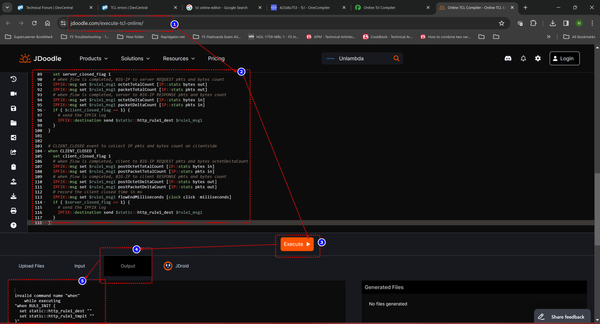

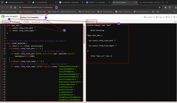

Hi Adick,
There are many TCL online editors that you can check your code, you can make changes and execute till you find the desired results.
https://onecompiler.com/tcl/423z8u753https://www.tutorialspoint.com/execute_tcl_online.php
https://www.jdoodle.com/execute-tcl-online/
https://onecompiler.com/tcl/423z8u753https://www.tutorialspoint.com/execute_tcl_online.phphttps://www.jdoodle.com/execute-tcl-online/
Hope this Helps.
