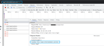

      With redirect instruction, client sees this. As you can see URL was changed to new host and URI is cropped and retained.
      LTM logs:
