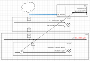

SNAT is not working in a one-arm configuration.
- Jul 19, 2023
Could you add the follow irule to the virtual server?
when HTTP_REQUEST { # Disable the stream filter for client requests STREAM::disable } when HTTP_RESPONSE { # Disable the stream filter for server responses STREAM::disable # Enable the stream filter for text responses only if {([HTTP::status] == 200) && ([HTTP::header value Content-Type] starts_with "text")} { # Replace '10.100.100.200' with '10.200.6.1' STREAM::expression {@10.100.100.200@10.200.6.1@} # Enable the stream filter STREAM::enable } }
