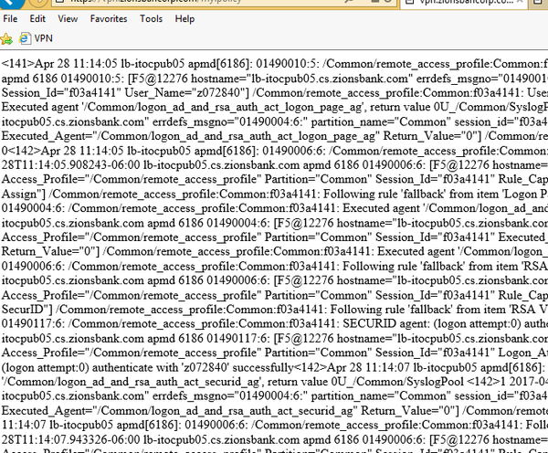

  4. After putting in login credentials and clicking login or refreshing the browser they are presented with all of the session logs from their previous session.

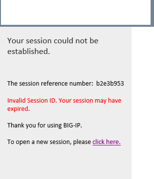

Here's what the page looks like before you click the link:
As soon as the link is clicked, you get a page full of this:
These are the same logs I see in our syslog server.
At the bottom of the page I see this text:
HTTP/1.0 302 Found Location: /renderer/apd_inspection_host_enter_page.eui APD_Result: 1,0 APD_AgentName: /Common/client_checks_1_act_hd_software_check_ag APD_SID: f03a4141
Content-Type: text/html Content-Length: 35 /apd_inspection_host_enter_page.eui
