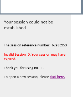

After working with F5 support it was determined to be an unpublished bug. Engineering hotfix 271 corrected the issue.
Haven't seen a bug ID yet. I engaged F5 support and they released a Engineering hotfix within a few hours of opening the ticket. 12.1.2.1.256.271.
Also, they state that if you have APM logging level set to debugging, which I did at the time the issues were occurring. The debug level is a contributing factor, I changed the logging level back to Notice and no reported issues since. will be applying hotfix this evening.
Support also recommended restarting the apmd as a work around. bigstart restart apmd
Hope this helps.
