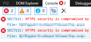

Apparently there is a JavaScript that helps creating this PDF file. First we get the "Internet Explorer is not showing all of the content". When accepting that we get nothing. When checking the debugging you find this:

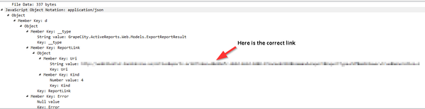

The JavaScript is generating a URL of http:// when we have an active session running on https:// and security is being jeopardized. When going to the exact URL that reports the error but changing it to https:// it works straight away.
So I know what the problem is but I have no idea how to fix it. Long term would be to turn on HTTPS on the back-end server but that will take some time and we need a fix for this quite fast since they cannot print out these reports if they are not in the local office, connecting to the server directly.
I tried searching through the JavaScript to see if I can find where it actually uses http:// and just using a Stream Profile change it but I have not found anything.
I also tried to add a Stream Profile changing Source: http://[URL] to Target: https://[URL] but that bricked the site.
Since the problem is the JavaScript, the browser won't even send the request to the F5. If it were to send the request to the F5 it would hit the iRule and get redirected to HTTPS.
