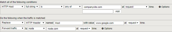

I have tried it via policy.
If I do it by this way, it forward/redirect me to www.google.com, but this is not solution, solution is to see companysite.com and be on site www.google.com
And when I add there forwarding traffic to particular pool, replace rule is ignored.
Do you have idea, what could be issue ?
Thanks
