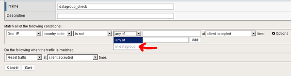

I already have a policy with implicit rule to forward all traffic to ASM
So I'm trying to add a rule above it to reset all traffic that does not match those two datagroups:
country_list
internal_addresses
But as you can see, when using "is not", the "in datagroup" disabled and cannot be checked
 This only happens in "Geo. IP" condition
I have 13.1.3.4 by the way
What can be does to solve this?

    • Abed_AL-R's avatar
      Abed_AL-R
      It is not a browser issue, since i checked with ff and chrome, same results
      I have another F5-VE 15.1.2 and there I can select 'in datagroup' only if I select 'is'
      When I choose 'is not' the option for 'in datagroup' is gone

        Uh, my bad. I didn't pay attention the very important is and is not. You are right, this doesn't seem to be possible - datagroup is not available any longer.
        So your datagroup is actually sort of an allow list. If my country code is in the datagroup my connection won't be reset.
        I don't have an idea to solve this one.

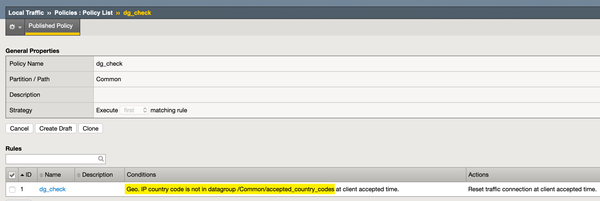

  • Created in the GUI, I ended up with a test policy similar to what you are describing, with no option to set "is not" on a datagroup:
    ltm policy dg_check {
        draft-copy Drafts/dg_check
        last-modified 2021-03-30:02:07:31
        requires { http }
        rules {
            dg_check {
                actions {
                    0 {
                        shutdown
                        client-accepted
                        connection
                conditions {
                    0 {
                        geoip
                        client-accepted
                        country-code
                        datagroup accepted_country_codes
        status published
        strategy first-match
    However, if you go into the command line and modify this in tmsh, it appears to work:
    root@(ltm3)(cfg-sync Standalone)(Active)(/Common)(tmos)# modify ltm policy dg_check legacy rules modify { dg_check { conditions replace-all-with { 0 { geoip client-accepted country-code not datagroup accepted_country_codes } } } }
    root@(ltm3)(cfg-sync Standalone)(Active)(/Common)(tmos)# list ltm policy dg_check
        last-modified 2021-03-30:02:09:04
        requires { http }
        rules {
            dg_check {
                actions {
                    0 {
                        shutdown
                        client-accepted
                        connection
                conditions {
                    0 {
                        geoip
                        client-accepted
                        country-code
                        not
        status published
    And then it appears in the GUI as expected (until you mess with it, then it is not recoverable there)
     I was not able to create a draft and then publish in tmsh (likely an error on my part). Using the legacy keyword I was able to work around that, but be advised my example makes immediate changes to the published policy.
    I have NOT confirmed that the not keyword in the condition will function properly in this policy. If it does (please test and let me know) then this is very likely a UI bug and not a problem with functionality.
